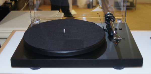

[Pro-Ject introduced no fewer than four new models, ranging in price from $399 to $12,000. The Pro-Ject Debut Carbon replaces the Debut III and features a carbon-fiber, rather than aluminum, armtube. This makes the Debut Carbon the lowest-priced record player with a carbon-fiber tonearm. The ’table also features a full 12** platter (up from 11** in the Debut III) upgraded motor-isolation system, RCA jacks so that you can use your own phono cables, and a choice of seven colors. The outstanding Ortofon 2M Red cartridge (itself $99) is included in the $399 price. Great analog has never been more affordable.]
Pro-Ject Debut Carbon:
http://www.project-audio.com/main.php?prod=debutcarbon&cat=turntables&lang=en
