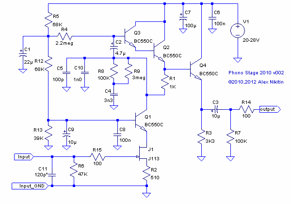

Si alguien quiere hacerse un buen previo de phono, MM ó MC, fácil de construir y económico, este puede servirle:
http://www.diyaudio.com/forums/analogue-source/151527-how-convert-creek-obh-8-mc-cartridges-2.html#post3179083
http://www.ant-audio.co.uk/index.php?cat=post&qry=circuit_ideas
[That version can work with either MM or MC cartridge. For a medium-output MC cartridge (~0.4-0.7mV@1kHz) the input FET J1 should be 2SK170BL, R2=68 Ohm, for a low-output MC (~0.2-0.3mV) on top of these changes R2 needs to be shunted by 1000uF 6.3V quality capacitor - that doubles the gain to ~65dB @1 kHz. The input resistor R6 should be chosen for the required cartridge load (100 Ohm - 1kOhm), R15 replaced by a wire link and I usually use C11 = 1nF for MC variants.
For input FETs a selected pair should be used.
Noise levels in this circuit are very good both for MM and MC.]
